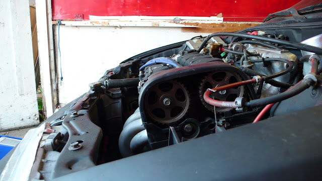

It all begins about ... hmmm, 8 years ago or so, when I finally purchased my 'dream car': a 1991 Honda CRX Si for $1250. It came with a turbo that I immediately sold, and that covered half the price of the car. I had a lot of adventures in that car, and was excited with every little change I made. There are reasons why everyone who's ever owned a CRX says they miss it. They're a ton of fun to drive. The engine was tired and smoky when I purchased it, and I limped it along for another 80k miles before it tossed a rod out the front and through the radiator, so I replaced it with an engine from an Integra. The swap was pretty badly documented, with piecemeal advice/tips/tricks on various forums, and I pulled it all into one central documentation source.
Aside from a couple minor complaints about the car, I absolutely loved it and would recommend a CRX to anyone.

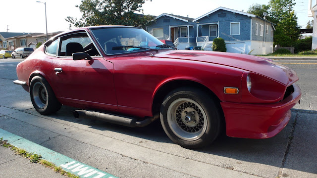

It ended up with a 5.4liter Chevy v8 in it (just a standard 350ci) and dual side-dump jpipes. This this was such a beast, but had major issues that I never fixed. The rear suspension was basically just steel blocks and the front end floated when you got on the highway (these Datsuns weren't known for being aerodynamically effective). It was the first automatic I ever enjoyed driving, with a big scary slap-shifter that would break traction any time you upshifted. Twice while I was getting on the highway it pulled up into a wheelie, and I decided that suspension setup was more important that power output at that point. I sold that off to a buddy, and you can see/hear it running on my site. That thing was such a beast, it's obscene.
Between my housemate and I, we regularly had 3 or 4 240z's in our driveway at any given time.

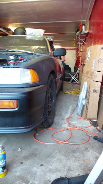

I couldn't help myself, and picked up another CRX, this time an 89 CRX DX, for $350. The CRX DX was a massive pain because it only had two injectors, and converting it to run on 4 is a huge pain (wiring is WAY worse when you're colorblind, by the way). That got a new engine, suspension, and a gutted interior before I sold it off.

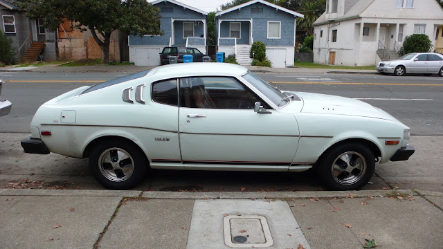

I picked up a 76 Celica to replace that for $400. It was pathetically slow, with a complicated carburettor and a terrible automatic transmission. Still, I had some great times tearing around a few of the mountain roads in Berkeley, CA. I think I sold it for $1500 or so.
