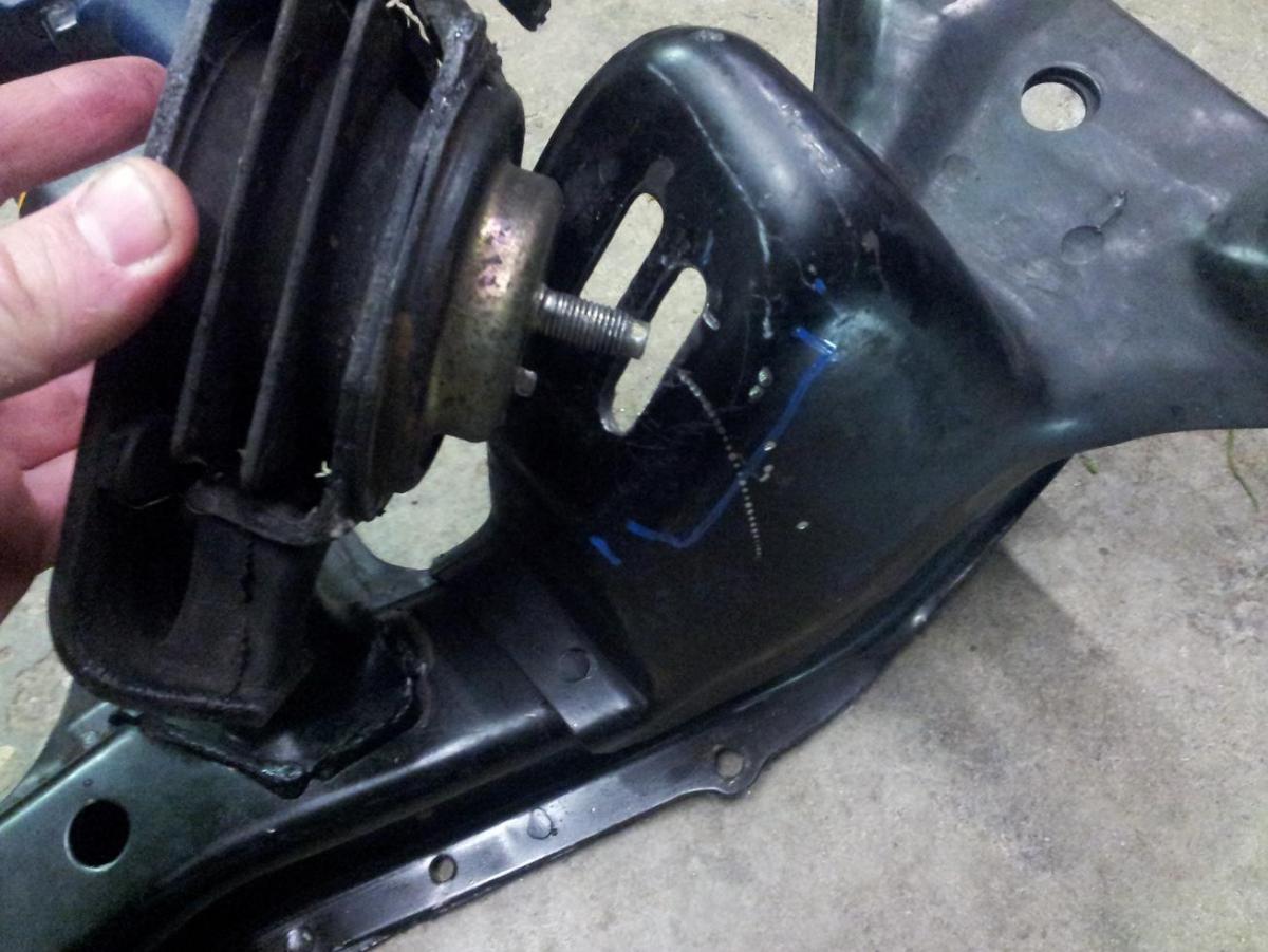

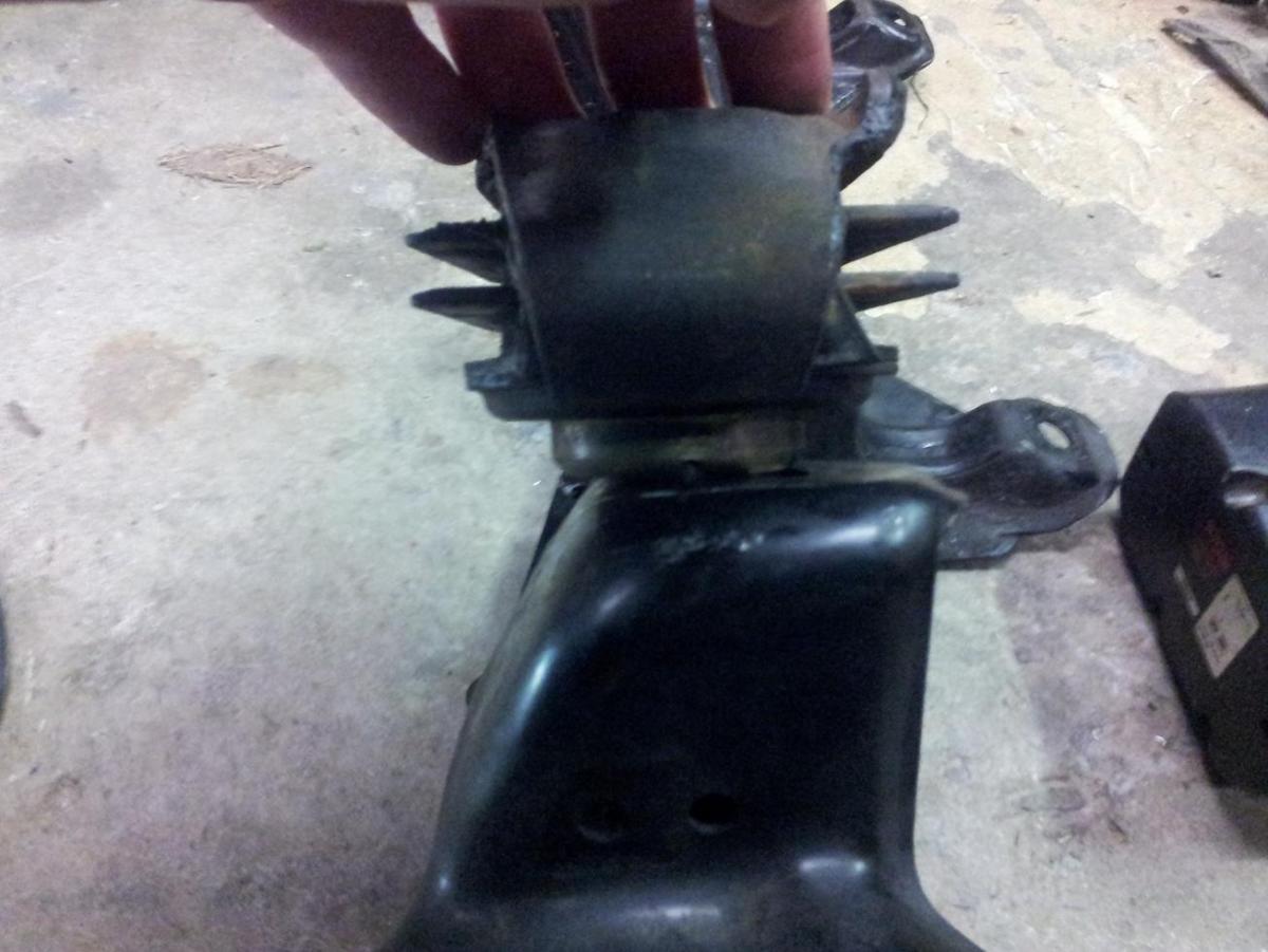

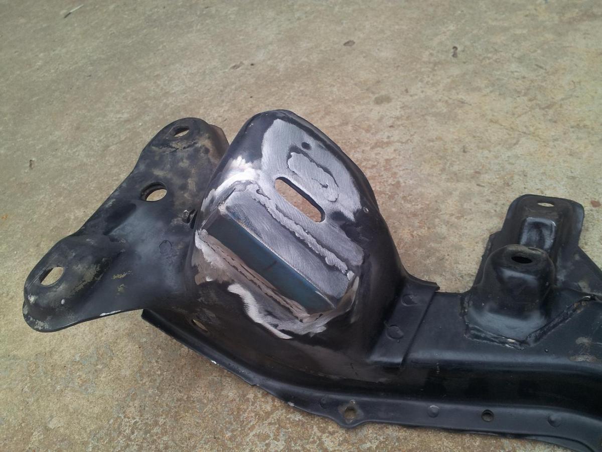

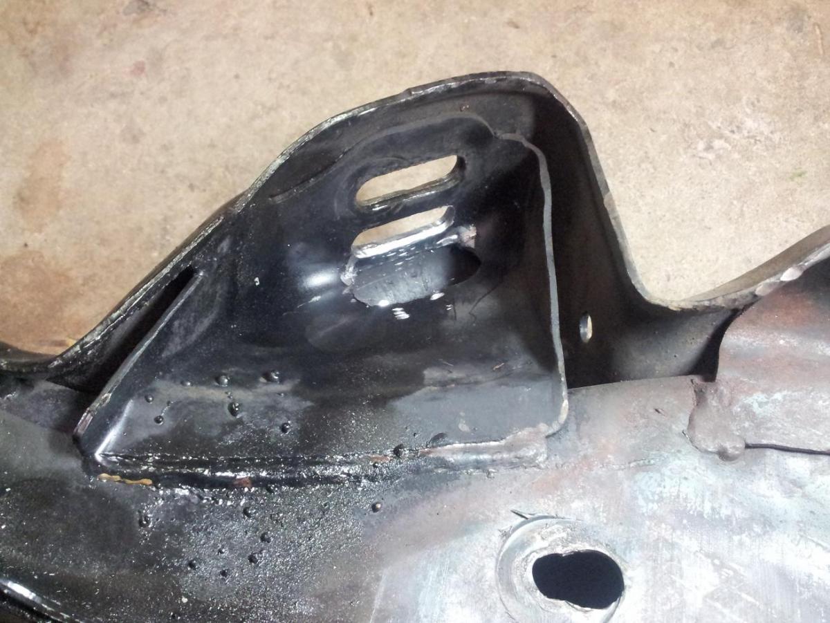

So here's the mods I did to the S13 crossmember.
New slots were drilled & filed with a die grinder, for turbo clearance on the LHS I've decided to run the engine mount spun 180deg, this means the slot had to be lower because the little notch that stops it spinning is now below the stud instead of above it.
Sitting further forward means the engine mount now does not site on a nice flat part of the crossmember so extra material needs to be added.
While adding the extra flat for the engine mount I welded up the old slots to keep it neat.
Nothing could be too simple. The crossmember is double skinned and the new position of the engine mount stud just fouls underneath which doesn't allow you to do a nut up all the way. More drilling & grinding so I can use a flange head nut. After this pic I rewelded the two layers back together and ground flat along where the nut sits.
Painted & refitted, engine block has been test fitted then removed again getting ready to start cleaning up the engine bay & finish radiator shroud once front suspension and wheels are sorted.

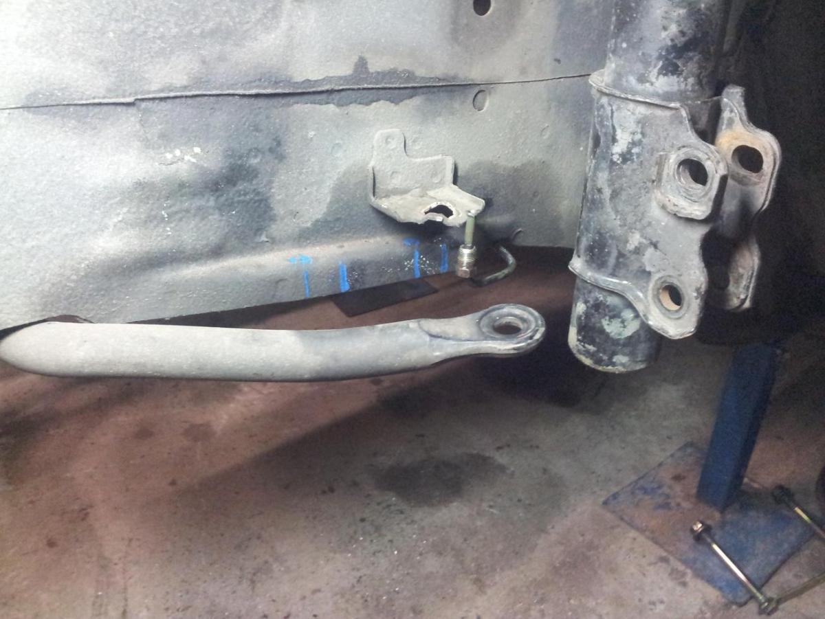

Just for interest's sake here is the LCA mounting marks on the rails for the two crossmembers. One pair has "13" painted at the top, the other pair is the S12 standard crossmember. You can see the S13 sits about 30mm further forward.

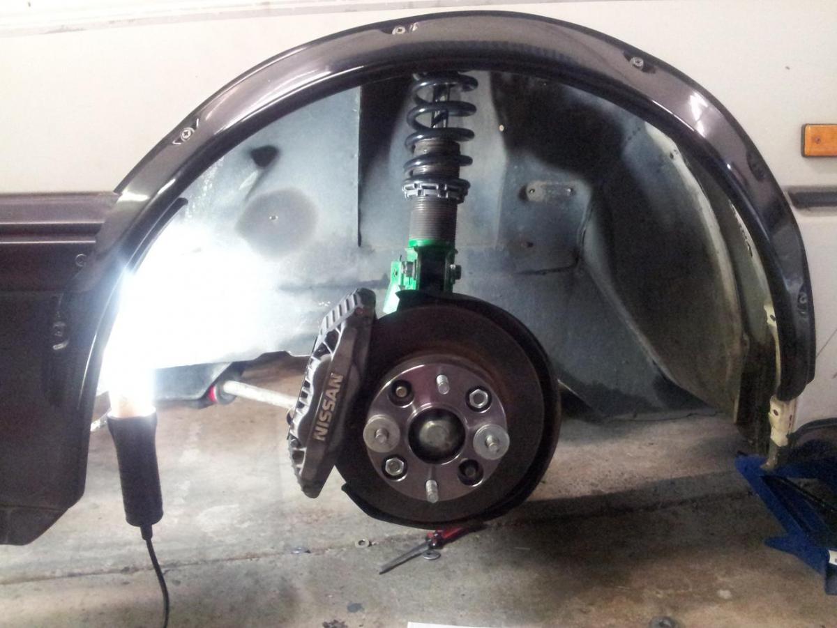

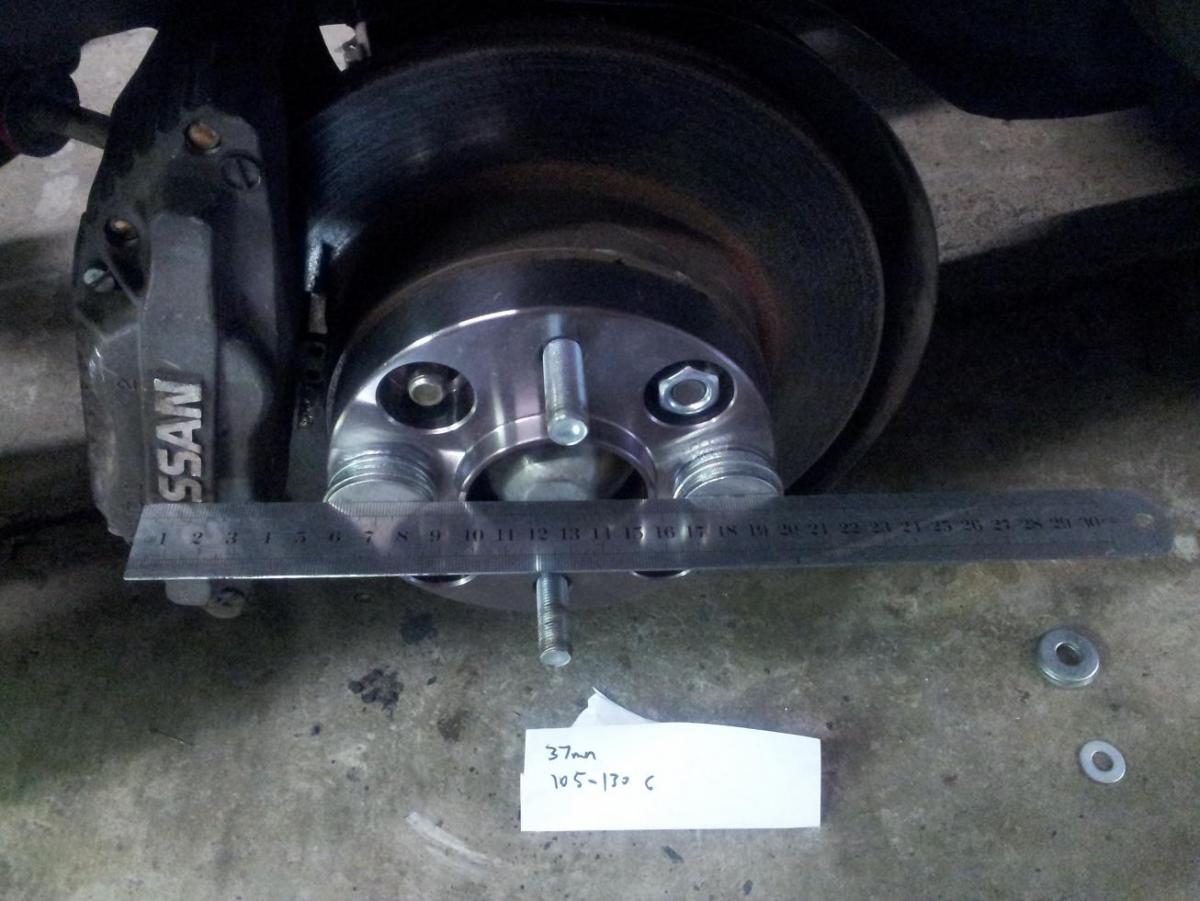

Fitted with the skyline brakes. Now camber is sorted I can measure up for wheels.
That's a 25mm bolt on spacer & 12mm of washers so 37mm of clearance required between 105mm & 130mm from the center of the wheel/hub which is where the nissan lettering on the caliper is. This is the part of the caliper that usually hits on the spoke. By holding the ruler in place & turning the hub I can check that 130mm clears both ends and the centre of the lettering.
After countless hours of searching I've just about decided on wheels. So many good & affordable wheels to choose from and pretty much every one I like doesn't clear my brakes or is only available in an offset for the front & not the rear. Would have loved Rota RBR, RKR, Shakotan, Kyusha, HM3 or Zero Plus, Enkei Apache II or any other old school style in a 15x9 but I need et15 front & at least et-15 rear. Would have gone to 16" too but same story.
I've even read that the Rota grid 16x8 et10 doesn't clear the brakes, needs 5mm spacer and the big brake clearance Rota 15s don't come in a 15x9, only the Grid V AKA Grid classic.
My best option is these Varrstoen V1.5 15x9 et15. They look to have a bigger back pad than the 15x8s which will help with brake clearance and give me ideal flare filling offset. If I stick to a 15" I can match it up with a 15x9 et-15 Rota Grid V on the rear. Ony thing might be a slight difference in color which I can probably fix myself.
If Rota made a better range of 16's I'd probably go up to a 16" but I bet they do as soon as I've bought 15's.
Just waiting on a reply from a couple sellers before I buy but if anyone else out there has a set of these & is happy to send me some measurements of the Varrstoens I'd be really gratefull.
Hopefully some pics with wheels in the next few weeks.

I've combed the wreckers over here measuring brake rotors and I found either holden commodore or ford falcon ones (pretty sure it was AU falcon) are about the right size & the disk is spaced back further but the disk starts to hit on the ball joint or very close to it. Also the way the caliper mounts are they sit to the outside of the mounts on the knuckle so you can't just use a basic shim to space them back, they need to be rotated as well so the mounts don't clash. It starts to get really complicated so I'm better off just leaving the brakes as standard bolt ons & finding wheels that suit. I have done a lot of measuring, research & work into spacing the disks back with OEM parts but haven't put it on here because it has led to nothing, the best way would be to run a 2 piece rotor/hat setup but it's not in the budget for my initial build.van_denton wrote:
This is interesting for me too! good write up. If its a total ball ache finding the wheels you want, could you find another disc and space the calliper back? not sure how much clearance there is to the knuckle/upright?
Might be worth investigating.
Also why are you using the s13 cross member? is it for the steering rack? what advantages are there?
As for why the S13 crossmember, the initial concept was to get power steering, to maintain standard S13 geometry right thru the front end (my caster is probably different now) & to get a wider front track without having to run negative offset wheels with a big scrub radius.
Not really knowing for sure what offset wheel I'd end up with until it was all in there, in hindsight if I'd kept the S12 crossmember I'd be looking for 15x9 et0 or et-5 on the front (race clearance not hellaflush) but considering S13s would have run an et30 (just guessing) from factory I think the closer to that you can keep the wheels the better.
I'm expecting it to take me quite a while to get the front settings in my car right but by running the full S13 setup hopefully all the development & testing that the S13 guys have done will directly translate to my car.
All this is only my uneducated reasoning. It could all be wrong & I won't know until it's all finished!!!

Based on the image you posted above the Varrstoen wheels should fit.
I went through the exact same thing with my S12 when it came to finding wheels. The only new option (I was only looking at JDM) I found was the Work Meister S1's, in a custom offset. But at NZ $2800, I couldn't afford it. I managed to find some 16x8.5 weds with MASSIVE clearance behind the spokes. (I'm also 5stud though, so you'll have heaps more options anyway.)
Good luck with the fitment! but I don't imagine it'd be an issue.
Also, if you'd mentioned it earlier, I could've told you all the measurements for the calipers vs rotors.
You'd pretty much be able to get any wheel to fit with 25mm spacers, including the steel D-Window and 8-slot style wheels, I know, because I have a 8-slot centre at home as I was considering this for one of my options.
