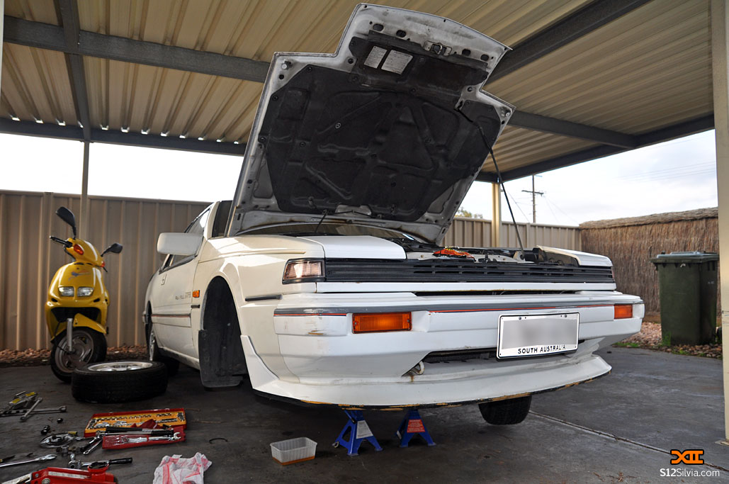

Today was very productive, I got all my parts together and swapped out the original suspension for a completely new setup. These are the new parts I have fitted to the RS-X...
Front bits:
S13 JIC Coilovers 8kg
S13 Lower Control Arms
S13 hubs
S13 Rack ends (shortened 10mm, thread extended 10mm)
R31 Skyline castor rods
S13 SR Turbo calipers
DBA 5000 slotted rotors
Nolathane Bushes
Rear bits:
Aurora springs 2.5" drop, 5kg
KYB Excel-G Shock absorbers
Wheels & Rubber:
Nissan 180SX Type-X Rims
15x6" +40
Kumho KU-18 Tyres 205/60/R15
Picture time...

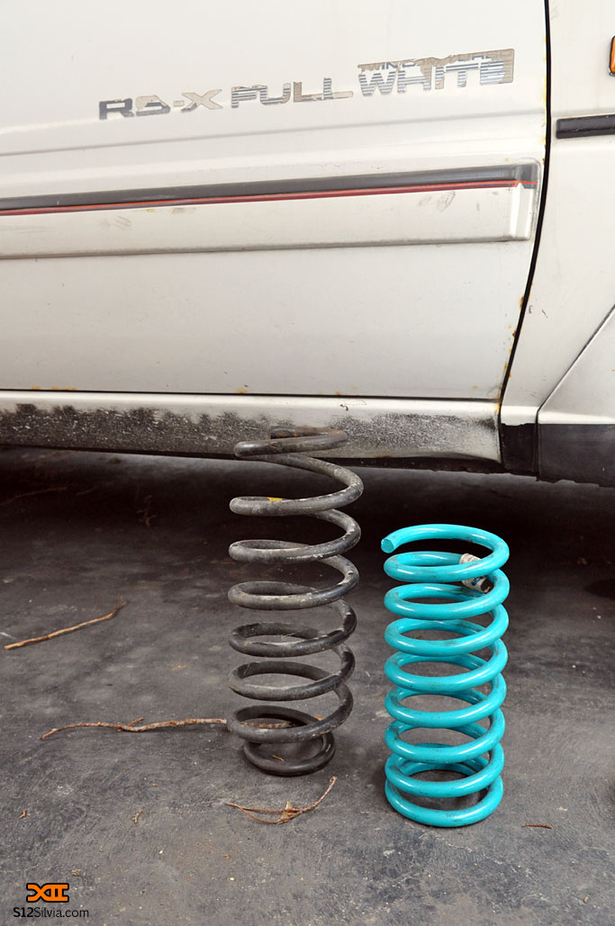

Original springs Vs. Aurora Srings:
Rear springs in. I'm thinking maybe 25mm worth of spacers if I decide to continue running these rims.

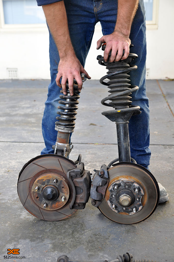

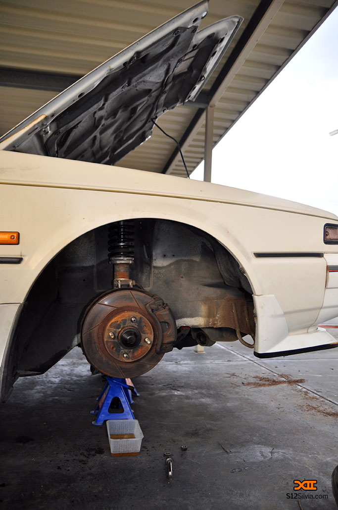

Front bits are out...
New setup Vs. Original setup...
New setup bolted up...

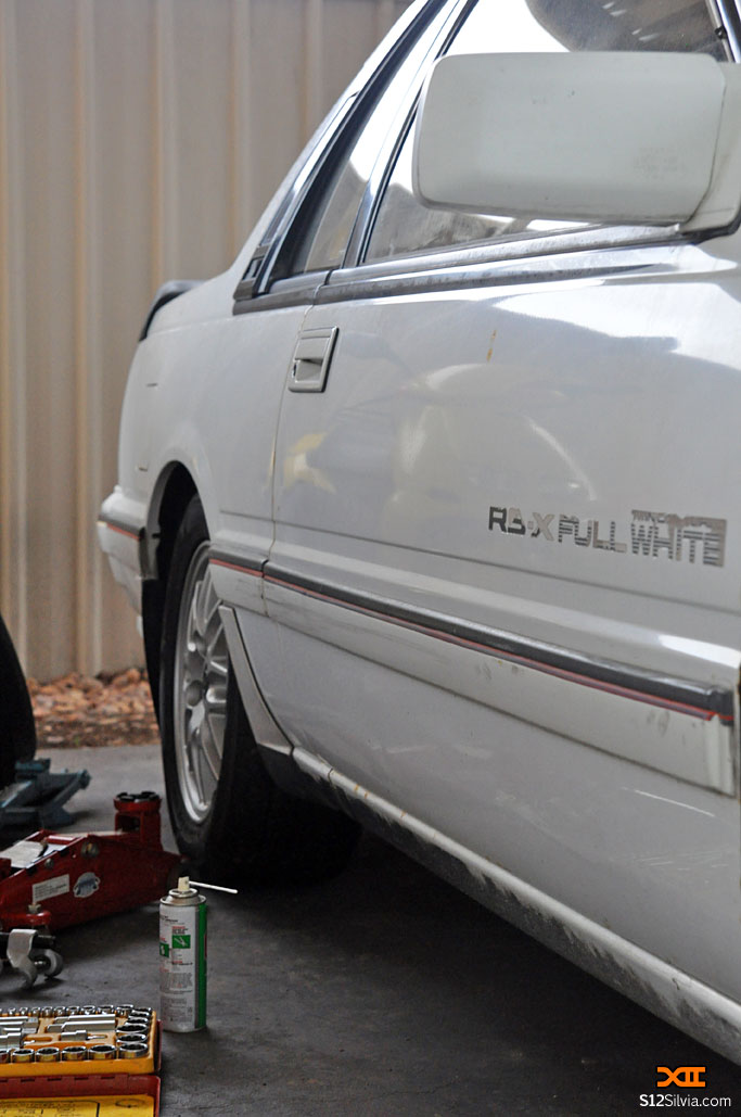

Today was playing with the suspension again. The front was sitting too low from when I put the new gear in. I adjusted this to make the car sit level. Fixed the scrubbing, and made it look a whole lot better!
Not major updates, but a good excuse to post some more pictures! Posted Image
