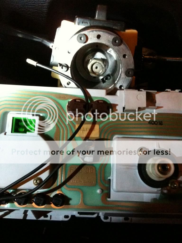

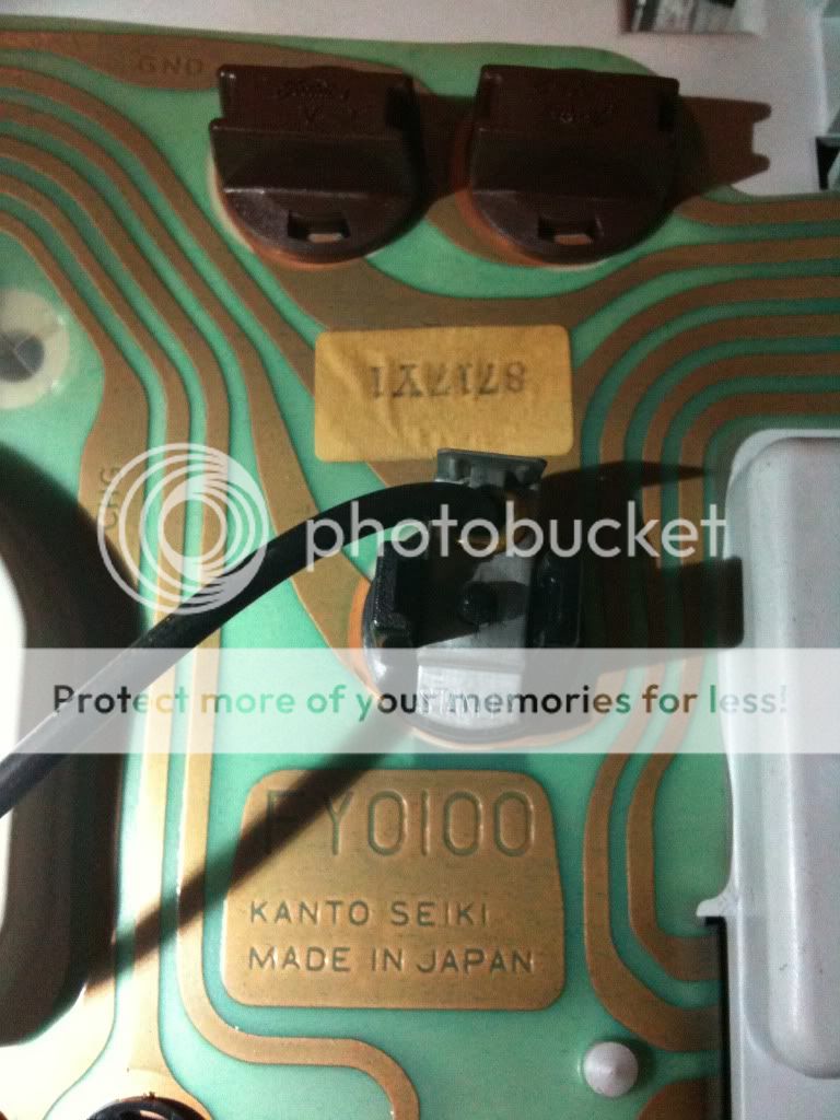

hey guys pulled out my gauges and found this wasn't plugged into anything but I don't know what itdoes do I need it lol and what does it do thanks guys

I guess you mean the little optical cable thing. Its a courtesy light for the ignition key. The cable clips inside the plastic steering column shroud and the end of it pokes through a little hole near the ignition barrel/key.

Correct. It's the fibre optic lead. Whatever you do, don't cut it off, or unplug it. You'll lose half the dash lights.
NO, you will loose EVERYTHING.... I did... Its rediculous... 3 weeks to find out it was that black penis hanging out the back of the dash that i thought did nothing.

I've got a black wire leading from a similar/same plug from the curcuit and goes nowhere??
Also thought about cutting it but i have instead tucked it away.
I luckily have all my dash lights ;)

thanks guys, your all so helpfull ;) :) its been hanging under the dash since i bought the car but never noticed it till now, now that im stripping out the interior i might just cable tie it up under the dash, i was just worried as i havent reali driven the car (well that far) that it might be something important lol thanks guys much appriciated
