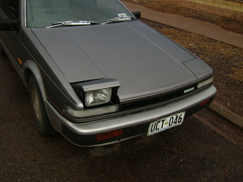

Sleepy eyes! ( Using the "donkeyconn ol' switcheroo" method)
http://i129.photobuc...ry/100_0056.jpg
Shhhhh.... Mabels tired now.

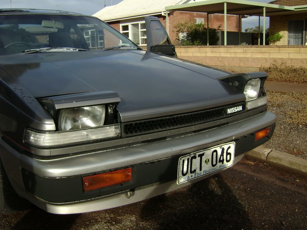

Posted 06 July 2007 - 06:37 PM
Winking eye :unsure:
N my sleepy's
