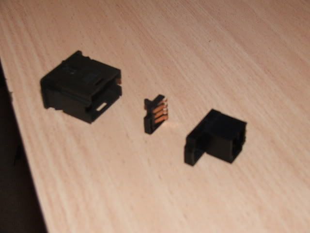

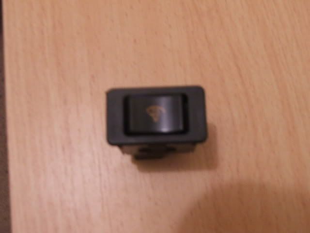

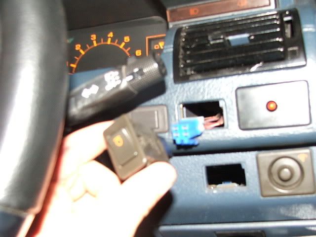

when i did my sleepy eye mod i found a much easier way to do it
without even havin to cut any wires
what you will need:
toggle dash dimmer switch
got this one for around $5 at u pull it (u pull it rules!! :P )
firstly take your original head light control switch out (carefully) and unclip the wires

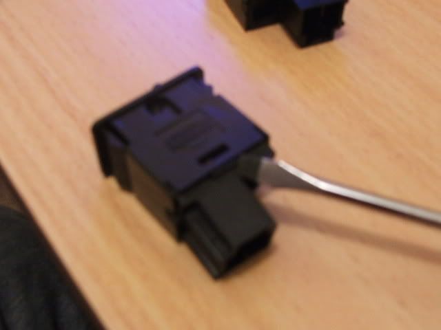

the next step is to remove the back of both switches. you can do this with a small flat head screwdriver but be careful not to break anything.
then you remove the internals.
once you have removed the internals of both switches its just a case of replacing the dimmer switches internals with the original switches. make sure you put the the backing of the original switch on the dimmer one so that the wiring in the car will clip straight on.
Hold it down for all the way up or down, or release when you want to get the sleepy affect
Bam, instant sleepy eyes :D :D
enjoy
