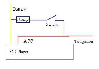

ACC needs to be hooked into the Ignition, to the ACC wire... so ACC to ACC, if you cant figure out wich is the ACC on the ignition, like myself, you can wire it with the yellow wire directly to the battery, if you do this, add a 10amp fuse, and a switch, so you can turn the CD player on and off, and it doesnt drain your battery.... add the switch to the red, ACC wire...
If you can figure out wich is the ACC wire on the Ignition, then remove the blue section of wireing, If you cant, Add the blue section of wireing, and dont send any wireing to the ignition

I tried connecting the ACC to the pink wires but to no avail, so I just connected the ACC and Battery wires together and it worked. Should I be using a fuse? And will it drain the battery if I turn the head unit off? Below is an illustration of what I have done. And also what I might do if I need to.
#9 SheppS12
SheppS12
    *Donating Member*
  • 175 posts
  • Location:South Yarra
Posted 05 July 2007 - 06:40 PM
The Fuse is a saftey feature, the switch is to. With my Cd player, i cant actually turn it off all the way, i can turn it off, but will have the clock displayed at all times, wich, if your not driving on a regular occurance WILL drain your battery, its like leaving the door open and having the intirior light on... I put the switch in to stop the cd player drawing power.
