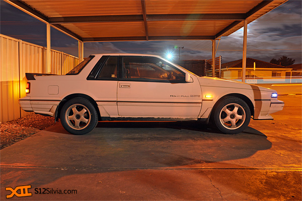

Life is busy, and finding time to work on the RS-X lately has been difficult. However, over the past few months I have managed to get through an extensive list of things, so here is a progress report…
I fitted new brakes on all four corners, with new pads and some fresh fluid. A new lower control arm on the passenger side, and new ball joints. New tie rods, steering rack boots, CV boots, and clutch slave cylinder. Just about every boot and bush on the underside of the car have been replaced with new ones. The Nolathane bushes I posted about previously have all been fitted, albeit with some slight issues along the way. The rear trailing arm bushes did not fit, and we had to mix and match some bushes from a Ford kit to get them in. Also the rear sway bar mount bushes did not fit, I’m still on the hunt for something that will. Some new tyres have been fitted and the car received a much needed wheel alignment.
Needless to say, the car now drives like new, I had to drag myself away from driving it all day. All this work has been done to ensure the car passes all the required inspections. It is now ready for the compliance process to meet Australian Design Rules. This will inlude the installation of side intrusion bars, rear seatbelts, and rear child restraint points which needs to be completed and reported by an engineer.
It’s getting there, slowly. Not too much longer before this will be legal and registered to drive, I can’t wait.

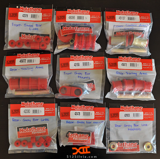

Attached Image: NolothaneS12.jpeg
My Nolathane bushes arrived today for the Full White RS-X. I will be replacing every bush in the car with a new one, should make it nice and fresh. If you are planning on re-bushing an IRS S12, these are the Nolathane part numbers you will need:
Front:
45137 – Lower control arms.
48095 – Castor rods.
42379 – Sway bar links.
42933 – Sway bar link washers.
42150 – Sway bar mounts.
Rear:
45072 – Rear trailing arms. (2 kits required).
42080 – Sway bar links.
42478 – Sway bar mounts.

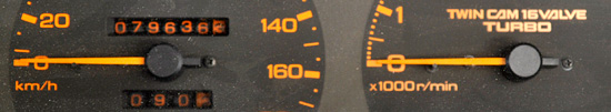

Posted by castle , in Feature Car: Full White 30 March 2010 - - - - - - · 91 views
Attached Image: FullWhiteOdo.jpeg
The number of kilometres on the Full White RS-X the day I got it.

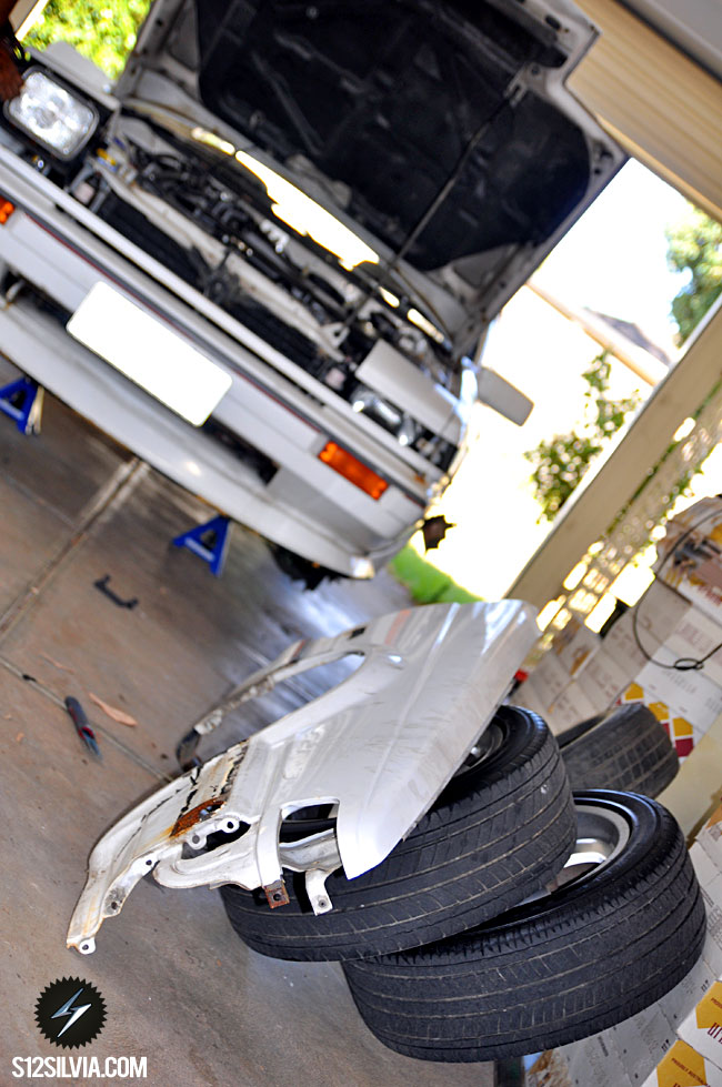

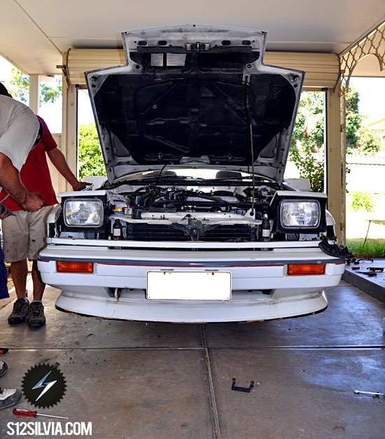

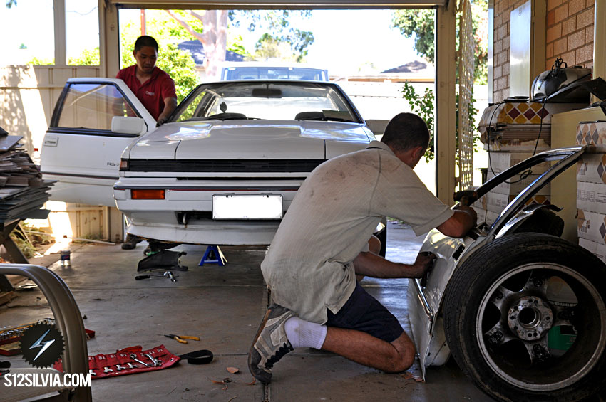

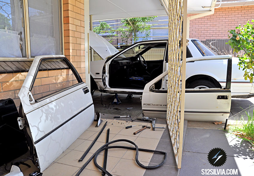

Work has now started on Project RS-X. Wil and I spent most of Sunday doing bits and pieces on the car. A donor car supplied us with a fresh front guard to replace the RS-X’s rusted one, and a straight door to replace a slightly banged up one. A few other things were fixed up around the place, and we drilled and fitted MKI windscreen washer nozzles. An Xtreme heavy duty clutch has been installed, and new brake rotors are in ready for the car to pass roadworthy inspection. It’s all starting to happen!
