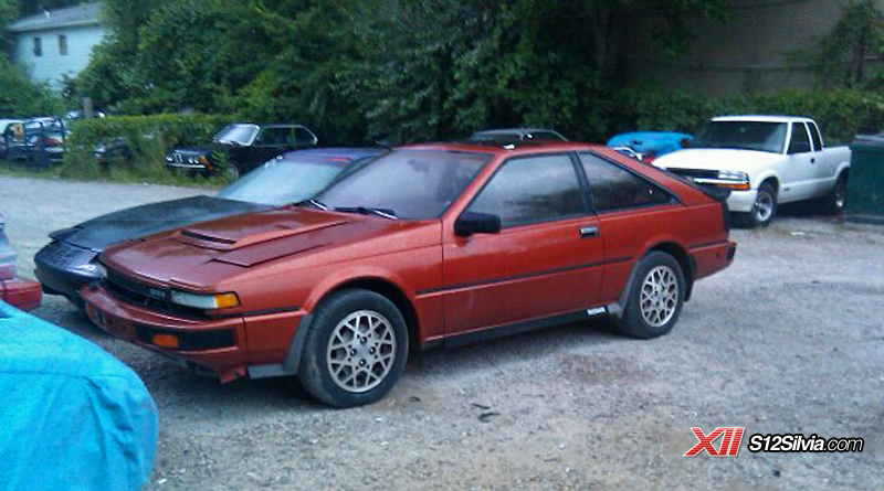

Devin: I had just graduated high school and I was really wanting to build my own car, so I was looking at cars to buy and I had found this original 84 turbo S12 in Indianapolis. I took my graduation money and drove 3 hours away and picked the car up for $600. It was the first car that I had bought with my own money and I didn't tell my parents about it for several months because I thought they would be angry that I had already spent all my graduation money on a old non-running car. I was so happy to have my own project car. After that everything just seemed to fall into place. It had the single cam CA18ET turbo engine that was pretty rough, of which my friends talked me out of keeping it and ended up helping me source a CA18det for it. While the engine was out, we tubbed the front end, installed a complete S13 chassis harness, full S13 front suspension and brakes, chose the color for the car (Nissan canteen green), and sprayed the engine bay. I stuck with the S12 because I wanted to do something unique that you didn't see all the time and I knew it would be cool and fun when I was done with it.

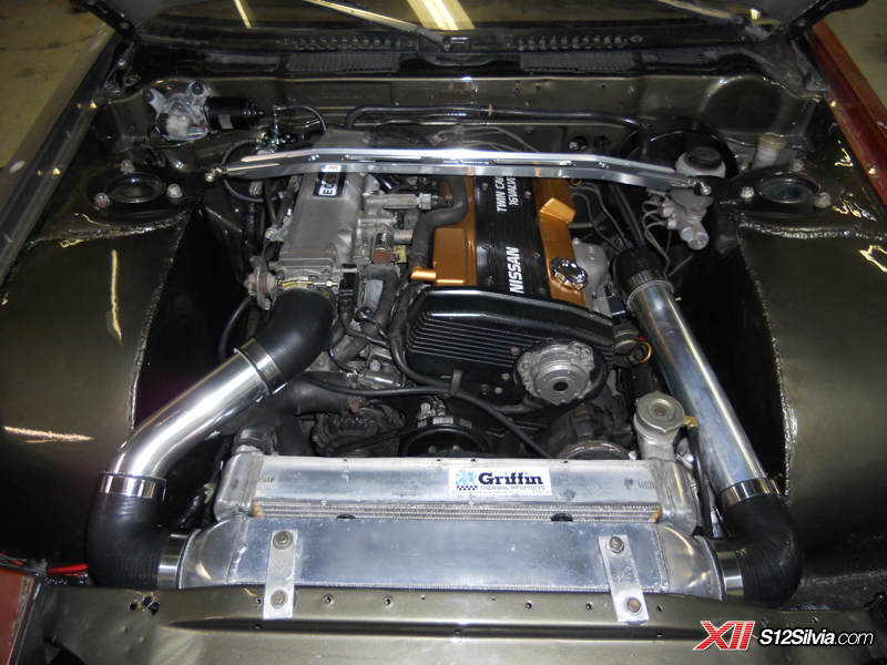

S12Silvia.com: Being that you had a very intimate role with the modification of the car, can you tell us some of the technical aspects of it?
Devin: Everything you see on the car is custom and has been done by me with a lot of help from the guys at HC Auto. It took a little over 2 years to get the car to where it is today.  It has been a long process of mods and changing, making it a little better every time.   Here is a list of the cars mods. Full front tubs, custom S13 front knuckles, s13 lca's, s13 rack and pinion, s13 megan outer tie rods, and modified steering column, J30 brakes, S14 tension rod brackets, CA18det swap with S13 Sr20 gt25 turbo, solid engine and trans mounts, centerforce dual friction clutch, fuel cell, walbro inline fuel pump, custom intercooler setup and Griffin radiator, Yonaka s13 coilovers, custom hydro ebrake, welded diff, full roll cage built by me and HC Auto,  S13 coupe  Origin body kit, Varrosten wheels V2 15x8 -10 front and rear, Sparco bucket seat, Teamtech harness and all rubber lines replaced with stainless steel braided lines.
